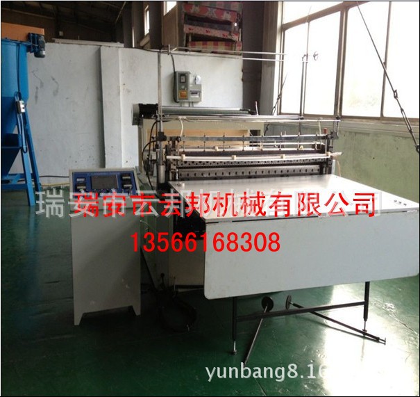

背袋吹膜机
背袋吹膜机
SJ-A505565651高低压超薄吹膜机
PE High & Low-pressure Blowing Film Machine
SJ-A50-65吹膜机
用途/USE
     本机组挤出机,机筒、螺杆均采用优质合金钢,经氮化处理和精密加工,具有耐磨性和耐腐蚀性,特殊设计的螺杆产量,塑化好。适用于吹制低密度聚乙烯(LDPE)高密度聚丙烯(HDPE)线性低密度聚乙烯(LLDPE)等塑料薄膜,广泛应用于食品、服装、垃圾袋、背心袋等民用及工业包装。
   Its extruder, cylinder and screw rods are made of quality alloy steel, that have been nitrogen treatment and processed in a precision way. Hence it is sound in hardness, durable in corrosion resistance. The specially-designed screw is of sound quality in plasticizing, which helps increase the production capacity. It is applied to blowing the plastic films like low density polyethylene (LDPE), high density polyethylene (HDPE)and linear low density polyethylene(LLDPE). It is widely applied to producing the packing bags for foodstuff, clothing, rubbish bag and vest ones.
